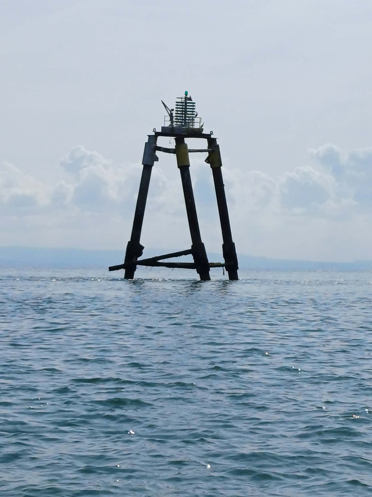

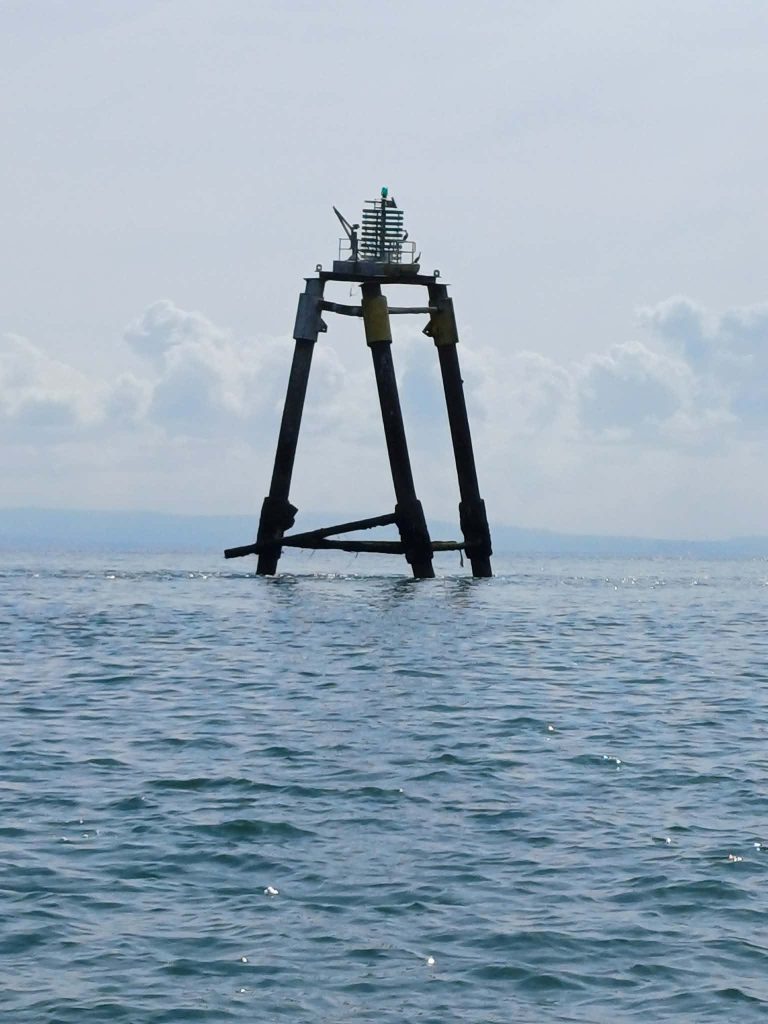

The important thing now is to enter the channel at the correct position,  about 2 cables north of the Hawes Point East beacon ( hopefully it will be repaired before it falls into the sea ) The white tower behind Triagos (below) is the leading light outer mark.
My waypoint  “Seldom”  is about a third of the way between Hawes East and the leading light white outer  tower structure.

2003 Picture of the Hawes Point East beacon
2017 Picture
2017 Picture of the Hawes Point East beacon

Aug 2021 Picture of the Hawes Point East beacon
Aug 2026 Picture of the Hawes Point East beacon, taken by Liam
